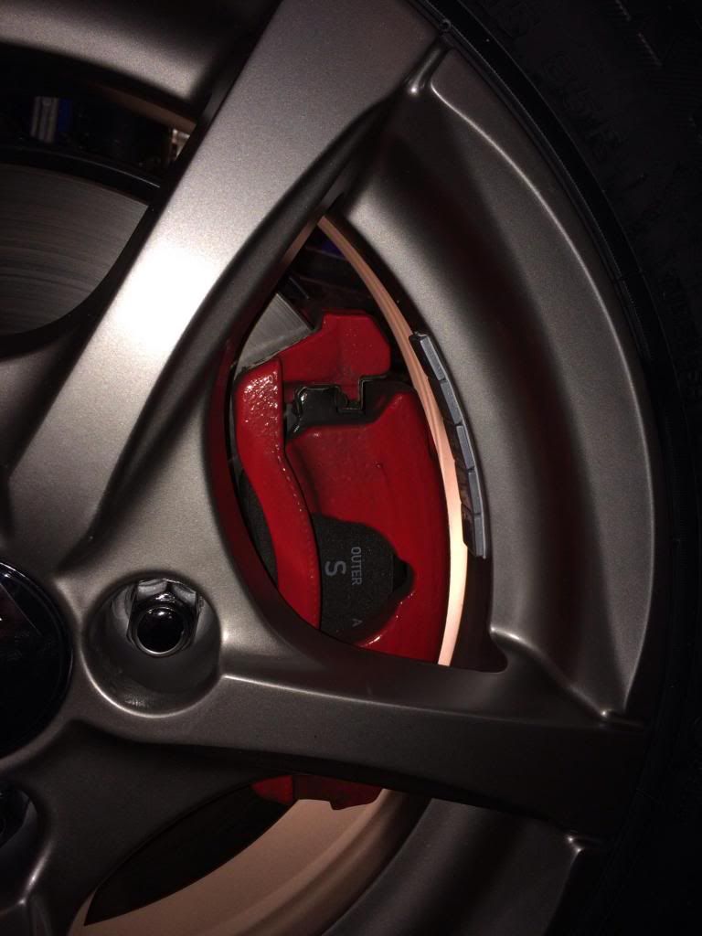

Here are a few pics of my 15 inch winter set up I choose the MSW Type 23 rims (Size 15x6.5 Offset 42mm backspacing 5.35 bolt pattern 4x108)
This is how close they are to the Brakes I have had NO issues at all (Tire Size is 195/55/r15)
Front
REAR'S
I have 15 inch rims on mine that I took off the 2012 fiesta and no problems
