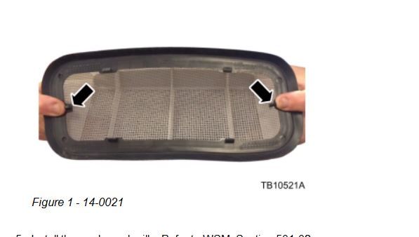

The foam is there to stop snow and ice from getting into the vents. Lots of people last winter had issues when snow/ice got into the vents and the fan wouldn't work any more making the car un-drivable in some cases.
282 Posts
I have a feeling the first few months they were making fiesta st's they didn't come with them. Mine was built July 2013 and it was missing the foam bits. There is a TSB around the whole snow and ice getting into vents and thus the foam bits is an after thought it seems.
Actually this is what's installed for the TSB,
Anyone want to share VINs from cars with or without the foam bits so I can check part numbers on the cowl panels? I don't see the foam bits listed anywhere.
