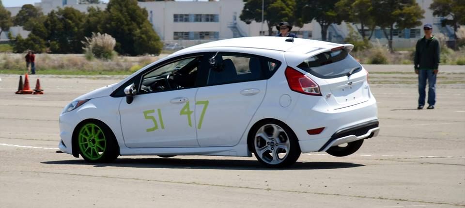

I ran 36/32 when it was around 40 degrees on the first runs on Sunday and they were fine until it started to actually warm up . I bumped them up to 40/37 (same as Alan) and it rotated well, this was with ambient temps near 56
This picture was during the afternoon runs
