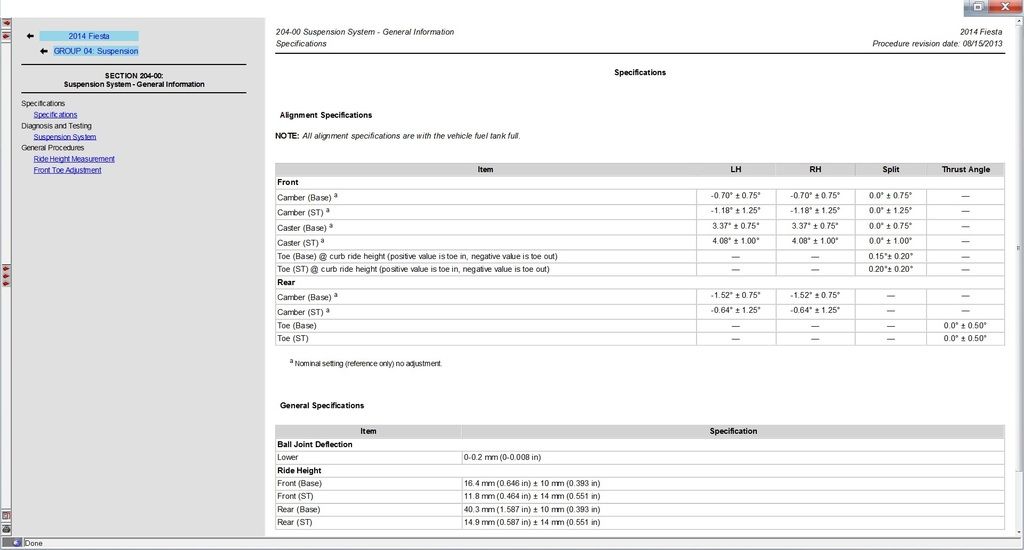

Weird. I'd have to see the oem specs.
I think the specs are something like -0.64 camber and nearly zero toe.
Hmmm. Definitely a head scratcher, I didn't even think the rear camber could be changed without a sledge hammer... I wonder if they missed a bushing or something.
Wow, thanks. Is that from the service manual?
Ya. I was able to get a CD copy of it. The only thing i have to do is change the date on my computer to something in Jan 2014 so that the disk will work
Ironically, it contains (as far as i can tell without actually checking) every 2014 vehicle. And maybe other years.
