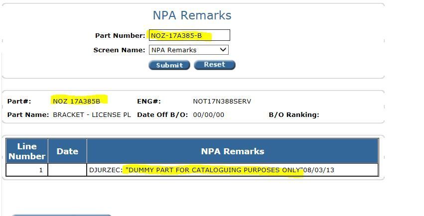

That's what the dealer did and the part number came up for the bracket I have. (NOZ-17A385-B)
It says "not used for this application" and even the picture showing is correct; just it only fits regular 2015 fiesta/ not 2014 or 2015 ST
Would be nice if someone could look on the back of their bracket that they removed.
Apparently your dealer is easily confused, that is a non-part number, it's catalog text only.
I just snagged a '15 ST VIN off E-bay motors from this car, http://www.ebay.com/itm/Ford-Fiesta...tr=true&hash=item235532f99b&item=151753259419 and I'm coming up with P/N D2BZ-17A385-BB http://www.tascaparts.com/oe-ford/d2bz17a385bb

Thanks for all your work! Detroit did get back to my dealer and sent me (though they claimed they would not guarantee a fit) but it works! The difference was the last two letters of the part number. The one I originally had was "AA" and the correct one was "BB" The problem was that my VIN will say that that part never was on my car, which is correct, it was sold in a non-front plate license province. Anyway, My problem is solved and I have a front plate. Thank again!
p.s. I probably had the wrong number in my previous email.
