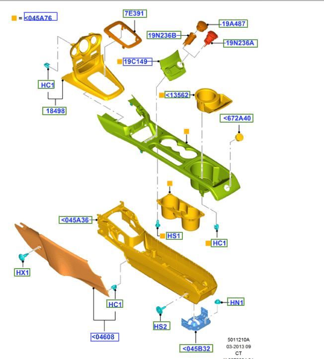

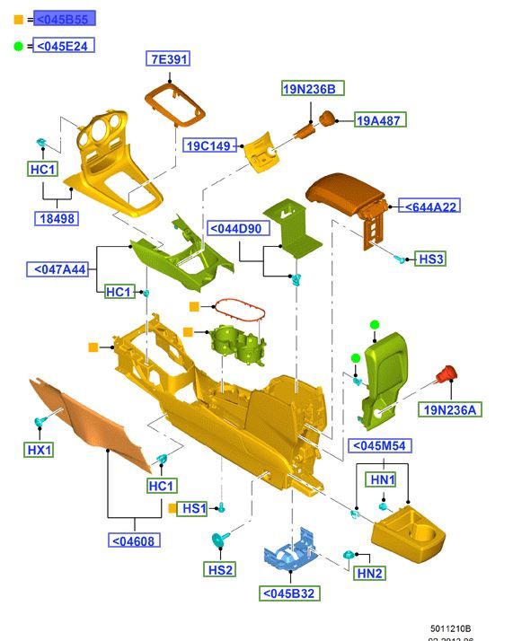

I can't stand the '14 Fiesta's armrest, it sits about an inch too high when my seat's adjusted properly so I'm always hitting it when I shift. For the moment I'm keeping the lid up but I'm considering ditching it for the early non-armrest console. From a look at the parts diagrams it appears that everything is probably interchangeable but it's hard to know for sure. Anyone had both type apart?

I believe the lower trim levels still have the old console design, so I'd imagine they are interchangeable. I think BRGT350 and a few other guys are planning on doing just that.
You'd lose the USB ports, aux port, and SD card reader unless you wanted to put that somewhere else. I don't think you'd have an issue using an earlier console though, the 2014 Fiestas use the original style console without the armrest. I hate armrests myself and from driving the Fiesta ST several times I never hit it with my elbow or anything. It's far back enough to not be in the way for me, though at that placement it is very useless as an actual armrest, but that's ok. I can still use it as junk storage and I like the USB ports being inside it so I can hook up a device and hide it in the armrest.

I think everything will swap directly over, but you will need to find a way to wire in the USB/Aux jack from the armrest canyon to the original location for the 2011-13 cars. You might lose the SD card slot, or find a method to attach it to the older console. Since the wires pass under the console from the infotainment center, you can plug the USB and Aux jack into the original console without any problems. Since none of the 2011-13 cars had the SD card, that might be a problem.

The 2011-2013 console should fit just fine, the only issue is the connections for the USB, Aux, and SD card if you have navigation. The USB and Aux on the early consoles are mounted between the shifter and the handbrake, where the 2014+ cars have them in the armrest. None of the 2011-13 cars had navigation with the SD card, so the project gets more involved if you have navigation on your ST.

Looks pretty interchangeable to me, should be about $385.00 for the parts needed to do the swap.
