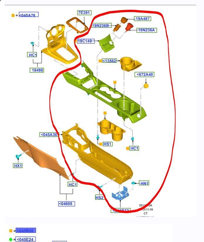

Steve, is it possible you could work up an invoice that would cover everything I need? From the diagrams I see there are quite a few similar parts, or it would appear so. Instrument panels 04608 RH and LH look to be interchangeable, as well as moulding 18498 which surrounds the shifter and HVAC controls. Too bad you are not any closer to work through this with me. This is the first thing I want to do with this car to make it 100 percent more comfortable.
The real questions involve the 19C149 panel and the 045A76 panel due to USB and sync options and also the 18498, there's only one option listed for the non-armest version but multiples for the car with armrest and I have no way to tell how interchangeable they are. Judging by the picture you "should" be able to reuse your old one.

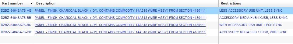

Here's what I have for options on the 045A76,

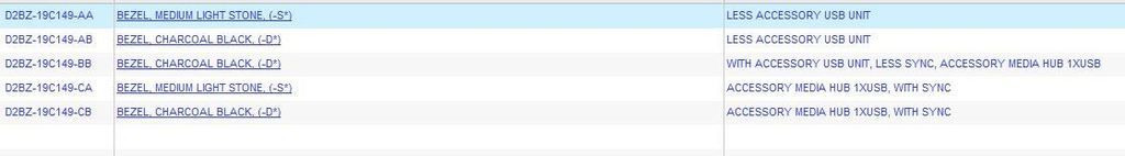

And the options on the 19C149,

I think 18498 has to do with what options are installed. So we have an ESC, Illumination, and dual seat heater buttons. I think (hope) that should work. The only problem would be if connecting points with the main console base are different.
As for as 19C149, correct if I am wrong, but it looks like the CB version since we want black with sync. The CA version is light stone and the rest are "less SYNC."
As for 045A76, it looks like the CB version again. I've seen it listed elsewhere as "w/o armrest, w/SYNC." But does that version include interior illumination?

045A76 is described as so, "
Floor Console Insert
Black/Black, With Sync, Aesthetic Lighting-Interior Pack 1, Ebony/Red No.2, Black/Cashmere, Black/Oxford White, Black/Blue, Ebony/Red; (-B*), (-C*), (-N*), (-R*), (-U*), (-Y*)"

Took about 4 hours as I ran into a few speed bumps. The consoles from different years use a different wiring harness than the ST, mainly because of the SD Card/USB/Line-in module in the armrest cubby. The whole wiring harness from the consoles need to be swapped. Also, there is no way to feed the line-in or USB on the older model consoles with the newer ST wiring. Therefore, I had to unwrap some of the harness from the ST to run the wiring for the SD/USB/Line module out of the bottom of the trim along the passenger side floor and reconnect the SD/USB/Line module there. I also had to swap power outlets from the old console to the new. The interior lighting is interchangeable, however you must relocate the interior lighting module to the new console. Luckily there was already a mounting spot the for the lighting module. Other than that, nothing cosmic or too difficult. The hardest part is getting all of the wiring harness out of the ST module. The connections for the interior lighting in the rear of the car are behind the back panel of the console, which is a beast to get apart. I usually follow the rule of never forcing anything when working on car interiors, but eventually it was only the brute force method that could get the back panel off.

Many thanks to Steve from Tasca Auto Group for helping me pick out the correct parts. If any wants to do this in the future please contact Steve. BTW, when ordering the only parts required are 045A36 and 045A76. You will reuse 19C149 from your own car. In addition, 045A76 comes with 19C149 already installed, as well as 13562, so no need to order those two parts.
