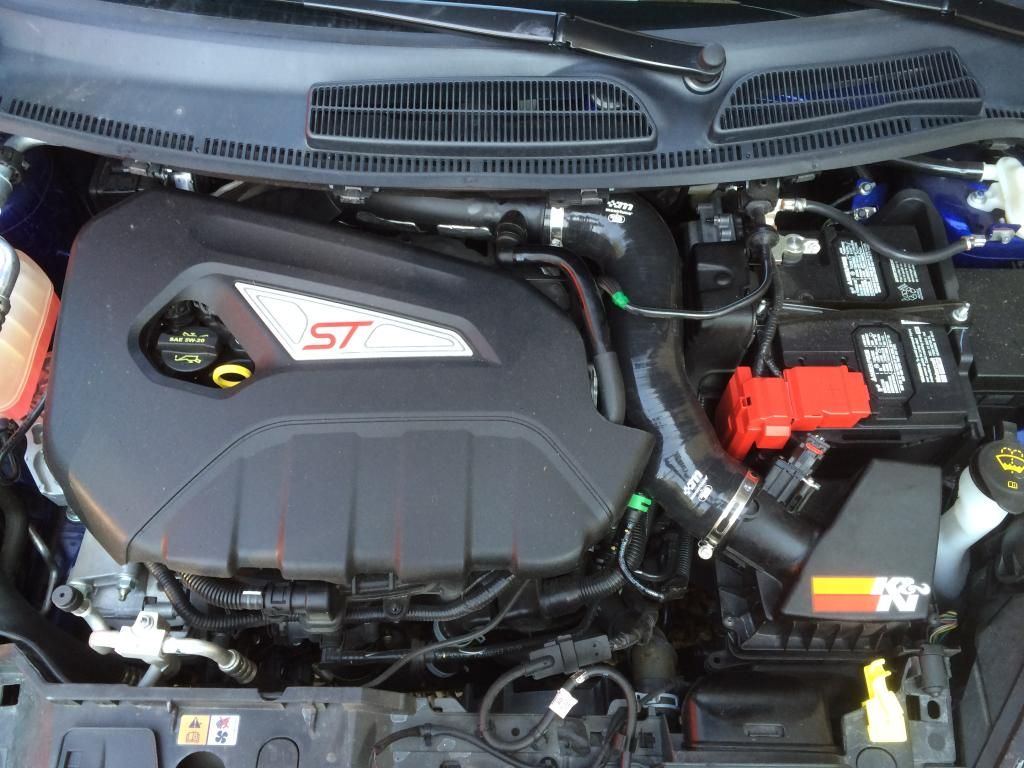

Finally got my Mountune Induction kit installed today, along with my first service.
For what it's worth I don't notice a huge change in noise this time, but did when I changed out just the filter and silicone hose.

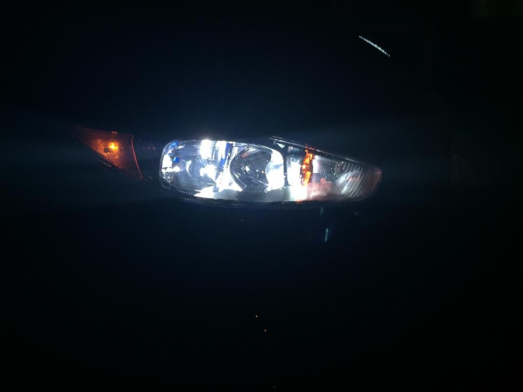

So today I gave my a car a Christmas present in the form of an HID upgrade.
I installed a 55W 6K DDM kit for the DRL/Low Beam
I measured and adjusted the height of the beam to North American spec, but the glare in the second photo makes me think they might need to come down some more. We'll see how many people flash their beams at me tomorrow and I'll adjust accordingly.
