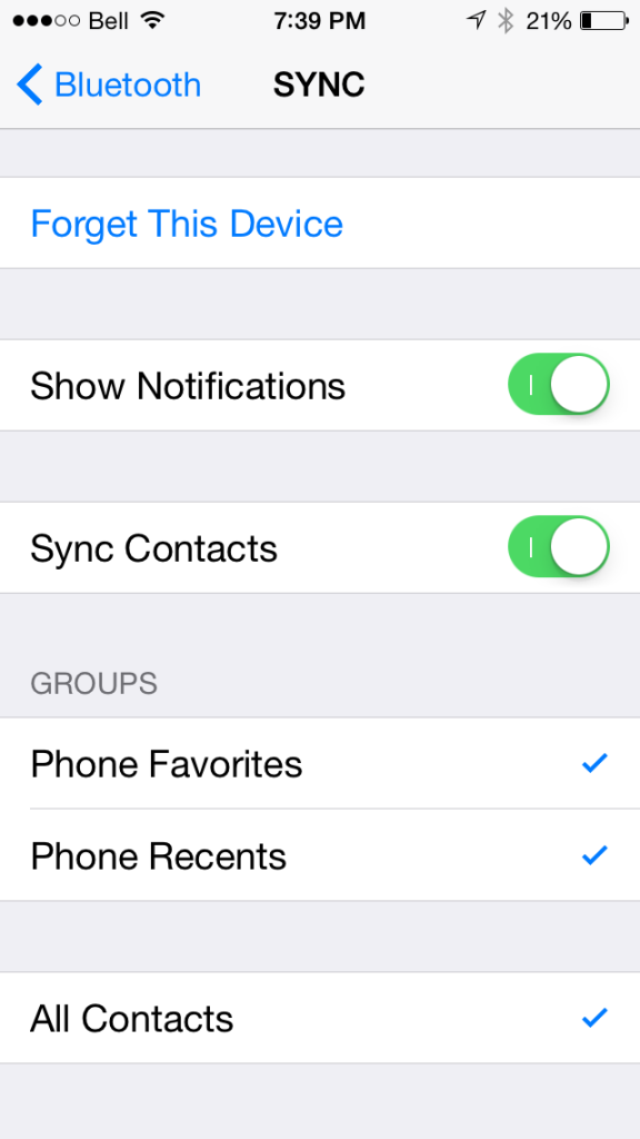

Hi. Recently updated my iPhone 5S to iOS 8 and just noticed that I've lost the ability for the ST to receive texts and the option to have the car read them to me. Anyone having this issue or is it just me?

You may have to tap the i icon next to the connected Bluetooth on your phone and enable the text option again. Dunno why mine would still work and yours wouldn't though.

Certain SYNC software versions will not allow that SHOW NOTIFICATIONS option to appear on the iPhone. Even though you've already tested this on your wife's phone, it's still a good idea to make sure your software is up to date. Just log in at: www.Support.Ford.com to check.
Once you've verified that you're running the latest and greatest, let me know which version you have downloaded and I'll let you know what I recommend.

The version I have is the most up to date one (version that came with the car when purchased). As stated earlier in the thread, I've never had problems receiving texts in the past with any of my iPhones.
Version Gen-V3.6.2

I'm having some similar issues too. I got iOS 8 before i got my FiST and everything but the texting seems to work. The option to show notifications is there. When I checked it was off so I switched it on by my SYNC is still telling me that my phone doesn't support the texting feature. I'm going to mess around with it tomorrow to try and get it working. I'll post any news (hopefully good).
