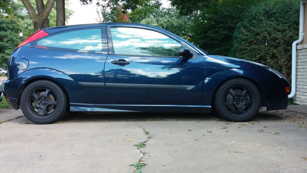

For auto-x, 15's make even more sense. The OZ is an ultra lightweight wheel. It costs $188 per set more than the Pro Race 1.2. Apples to oranges.
These are 15x8/4x108/35mm offset Pro Race 1.2 wheels w/205/50/15 Dunlop Direzza ZII's. 15.5lbs, $167 each/$668 per set + shipping.
