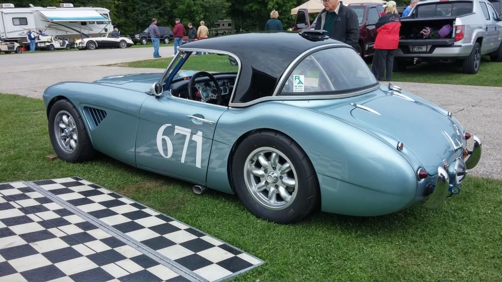

This is his car(my son riding shotgun), we're headed to R/A again this weekend with it for the Fall Festival. :)
He runs consistently in the mid 2.50s with that car and he could push harder but since there's nothing to gain from it he just goes out and has fun.

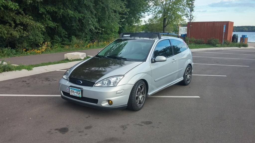

You're welcome to come look for us, We're usually in the grass paddock area on top of the hill on the left between the Gearbox and the gas pumps. Look for the Healey above or my silver SVT. I'm easy to spot, 6'6" and 225 lbs.

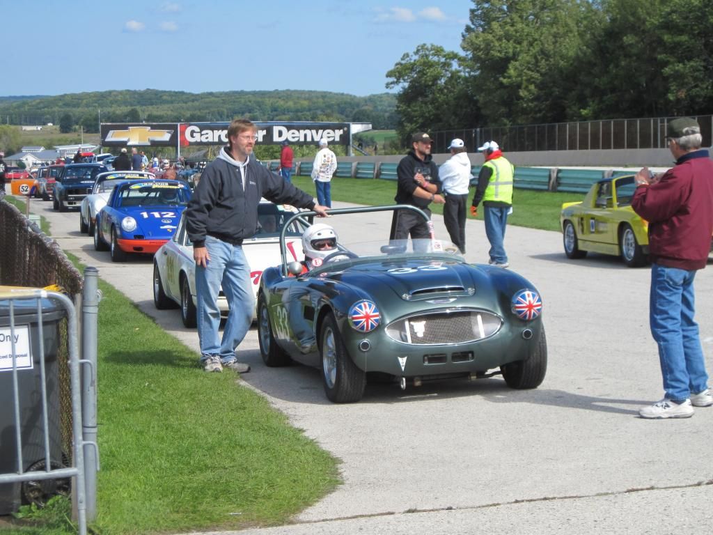

BTW, I should have mentioned that my dad actually got pole for the Sheldon Cup race on Sunday at R/A.
That's me holding the roll bar and our friend Rich (30+ year Formula Ford driver) taking our picture, pic above taken by another friend.
The pole was a timing error, they had him at a 2:32 (actual was 2:56) but after 30 years racing my dad figured he'd take it and just make his car real skinny at the start. From the start/finish to turn six he let 23 cars past and got back to mid-pack where he belonged. That Porsche right behind him won the race absolutely running away from the field and lapping a good portion of it.
Great time though. :)

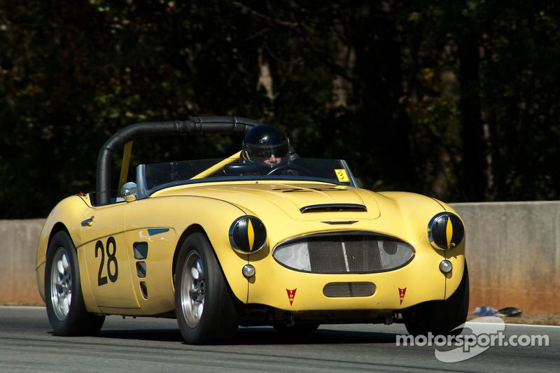

Our friend Jeff (yellow Healey #28) was involved in an incident coming in to turn 5 on Saturday afternoon, a Lotus 23 lost it, hit the wall and came apart, Jeff almost made it through but the front suspension of the Lotus bounced off the wall and slid out into the track and bashed in his right front. With some direction from Tom Kovac of Fourintune, the drilling of a few holes and the use of my dads Expedition we managed to get it straightened out to race on Sunday. Didn't take any pictures of the damage, poor form you know.
This is a very fast Healey, runs about 10 seconds a lap faster than my dads car,
