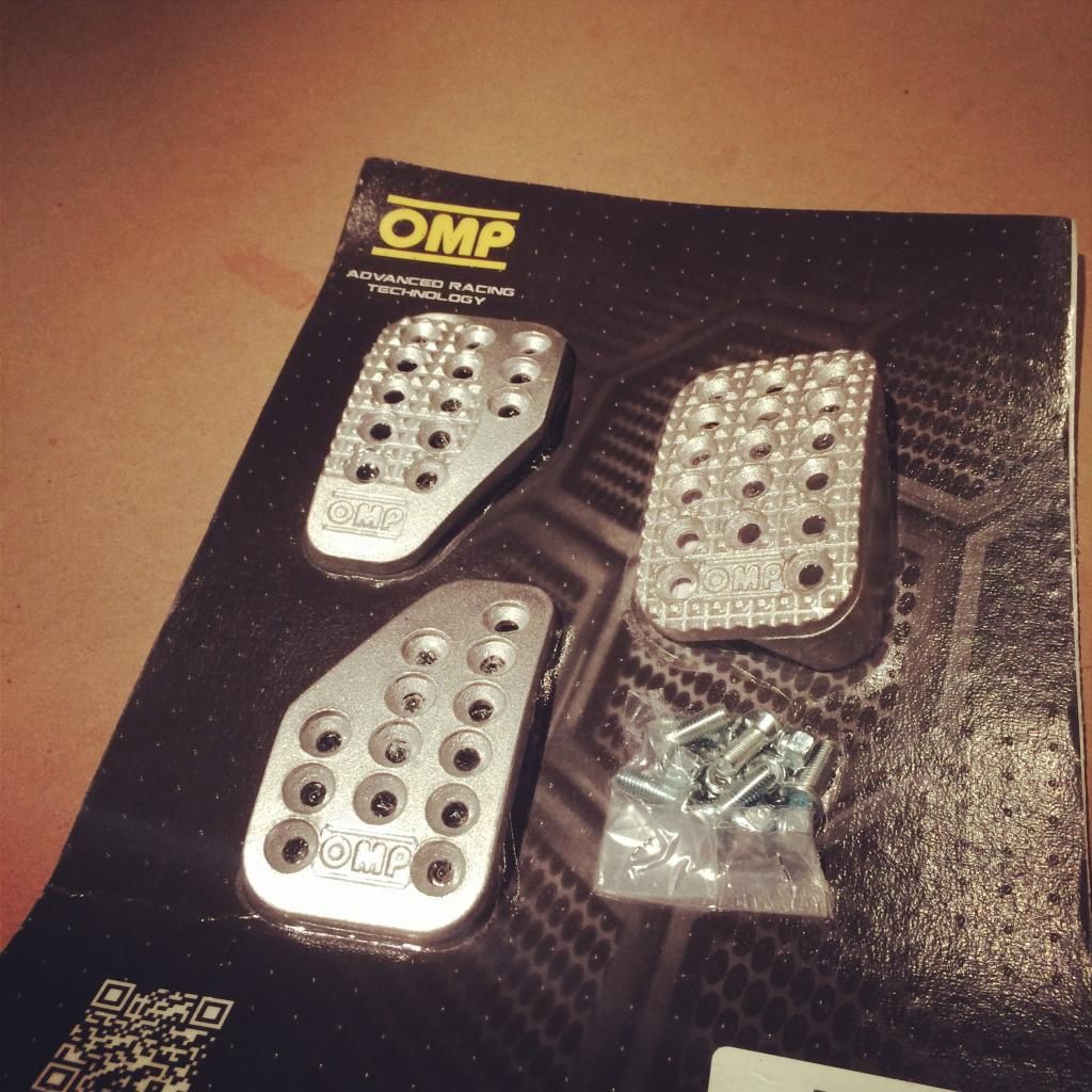

I ended up searching around for a solution and installed some OMP adjustable race pedals:
I was not sure on how to install them but after some time surfing the net and picking and choosing the best ways to do it from other installs I ended up doing this:

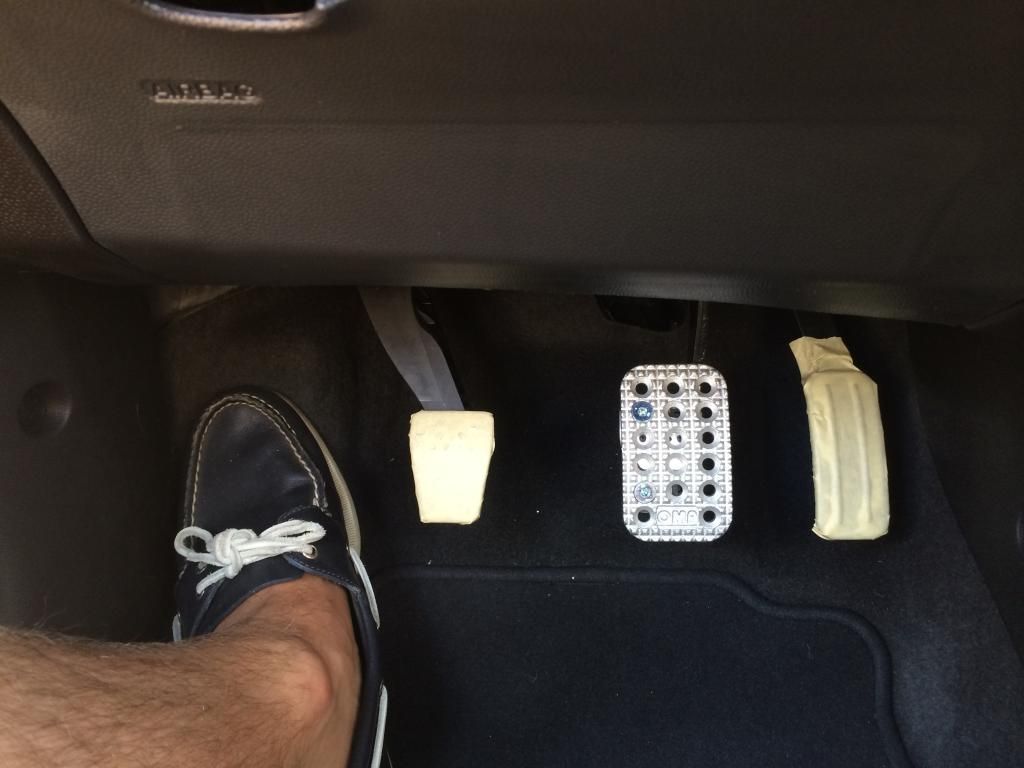

4. Find the location of the pedal where it will be the best to screw and anchor the bolts into. You do not want to screw through the arm that holds the pedal (however I had to do this for the clutch). Take these into consideration when setting up your pedals:
a. The pedal is in a good location for your feet to enhance your driving.
b. The pedal is in a location where two holes can be drilled into the metal surface of the pedal and a bolt can go through the front and a nut can be attached from the rear without any obstructions.
5. Use locking pliers to hold the OMP pedal in place to your existing pedal.
6. Mark the holes with a sharpie.
7. Take a center punch to indent the metal of the stock pedal so your drill bit does not "dance."
8. push the pedal to the floor with one hand and then start drilling the proper hole size with your other hand.
9. Remove the OMP pedal and the masking tape. Check your holes with the pedal. If you need to make adjustments to the hole you can always make it oblong with a tubular file or a strong drill bit with some lateral pressure.
10. Bolt it down and move on to completion of the other pedals.

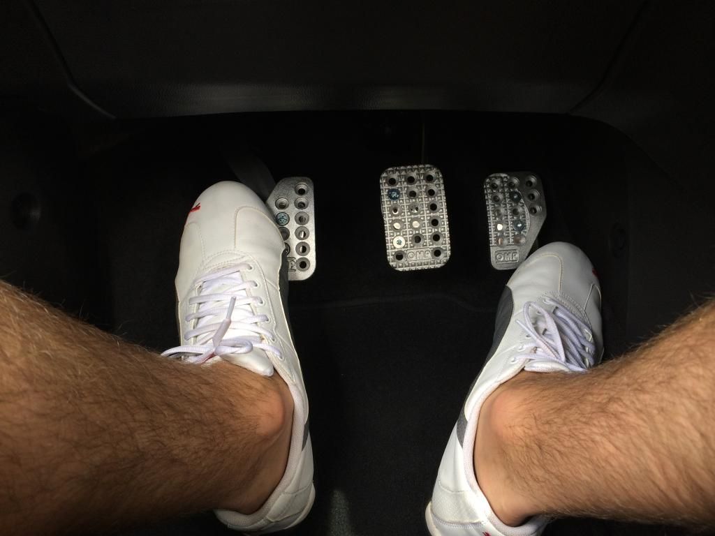

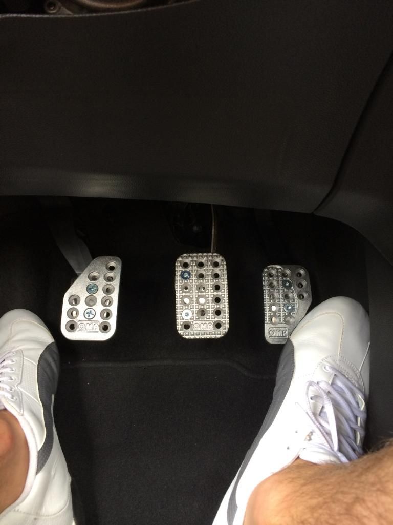

Completed:
The clutch was tricky and I had to drill through the plastic arm that holds the stock pedal. As a result I had to go to the hardware store to get some longer bolts with a tapered top so they would sink into the pedal.

Results:
I am very satisfied with the results and can finally drive my car north of 9/10's with confidence. The scary thought of my right foot slipping off the brake pedal and going off the road as I threshold brake no longer enters my mind while driving.
The position I have them in now is great for athletic sneakers. But if I were to use my racing shoes I would have to move the gas pedal one more notch to the left (and drill a new hole).

One of the biggest things that I hated about my stock Fiesta ST was the pedals and their positioning.
Sorry to have to tell you this but you have installed the gas omp pedal to the clutch and vice versa. The omp pedal that you have installed on the throttle is meant for the clutch and the little cut on the lower right corner is originally there to help you left foot brake.
You will notice the textured surface of the brake pedal and "my" gas pedal, this is to assist grip on heel toe. If "my" gas pedal was on the clutch:
1.) it would be too big.
2.) the textured grip surface would serve no purpose now.
3.) "my" clutch pedal would now have no textured surface for traction if placed on the gas.
4.) "my" clutch pedal would also be way too small to fit on top of the stock FiST gas pedal.
I read the instructions, they are correctly installed :)

ompracing.it/en_gb/car-kart-parts/pedalsets-footrests/oa-1000.html
Aren't these the pedals? I know for a fact that the pedal with the missing lower right corner is for the clutch to leave room for left foot braking. I have helped install these in an E46 M3. Maybe they are meant to be used both ways
I can see and appreciate your argument. I'll remain neutral on who's correct. My setup works best for me for the reasons I listed.
They have held up wonderfully to date. And my car up until now (no longer work at home) would see 8+/10ths whenever driven.
