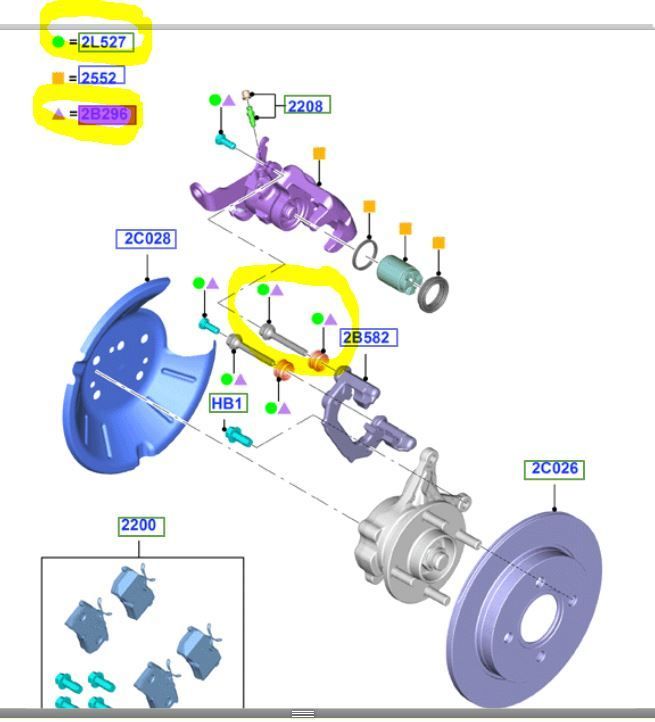

To be honest I think it's actually a catalog error, not a packaging error. I found a different number for the pin kit and Ford does have stock, 3-4 days out but they do have stock. P/N C1BZ-2B296-A.
As you can see Ford shows the pin coming in the 2L257 and 2B296 kits, pretty sure they only come in the 2B296 kit.

My 20+ years in Ford parts primarily. :)
With that comes all sorts of useful knowledge such as the fact that the Fiesta ST calipers are virtually identical to the old Mk1 Focus rear calipers and that's how the caliper hardware broke down on them.

You were correct. I went to the local dealership, ordered the C1BZ-2B296-A, and sure enough, the package contains the following:
  • 4 rear caliper guide pins
  • 4 bolts
  • 4 rubber boots
I just put them on the car, along with new pads and rotors(last two were from Tasca). I used NAPA 765-1351 "Syl-Glyde"(their spelling, not mine) to lubricate the pins.
BTW, noticed that just one pin on each side was badly corroded, and it's the pin closest to the ground. I suppose it's least shielded from road salt(MI). I have a feeling that during the next brake job, I will need the bracket(-2B582- in Steve's diagram above) that these guide pins fit into; the holes where the corroded pins belong are also slightly corroded. The pins on the top were less corroded, but not perfect, especially at the shoulder under the rubber boots.
