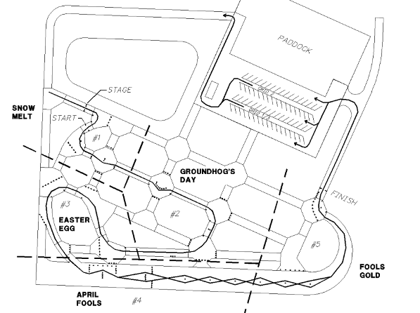

Our T&T is 4/5 on a course with concrete to asphalt transitions (octagons=concrete; strips=asphalt). This is a police driver training facility.
The guys have set up a fairly simple course with short and long, on and off camber corners, two sweepers and a long slalom. I have had hundreds of runs on this site with the GTI and other cars so have an excellent feel for car control and capabilities here so I am curious about the turn-in complaints of the ST. In hooning around town I can feel the rear end loosen up more than the GTI ever did. So it will be interesting and I'll report.
