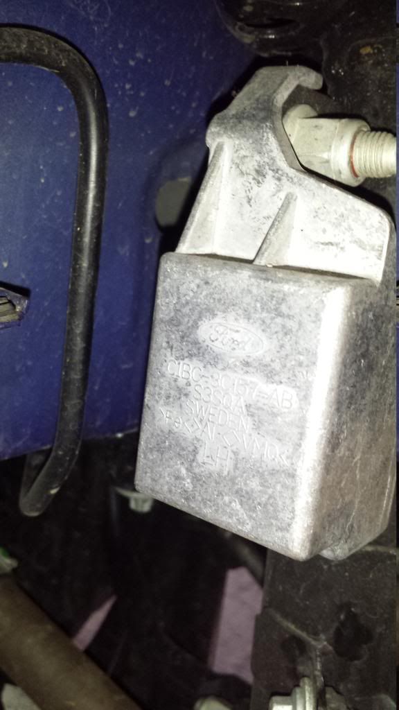

Anyone know what this grey box is? I'm installing the Bilstein coilovers right now but there aren't any mounting bracket for that box to bolt on to. I did some research and it seems to be missing on the BC Coilovers as well.
It's called 'suspension vibration damper' with part number 3c156 & 3c157. Wonder if it's really important to have that on...

How much does it weigh? I'm guessing it's there to lower the frequency of some sort of suspension resonance. I wonder if they couldn't find a more expensive vendor to make it, other than one in Sweden.

It's only about 2 lbs max. I don't think it does much and probably only work with the stock shocks anyway. I installed my coilovers without those and I don't see any problems

I would like to hear how it works out down the road. I know that my stock suspension will get a little spooky on a certain section of local new interstate. It feels like the tires are chattering even when going straight down this section of highway. Fortunately this is only about an 1/8 of mile out of 70 or 80 miles of Interstate.

All it takes is a simple mass change to adjust the resonance frequency. You'd be surprised what little changes are needed to make a big affect, especially when you take into account moments, etc.
If it's a dead weight I'd guess Methane Herder is correct. Hell, for all I know it could be there to absorb some vibrations to clean up the signals for the ABS/Torque sensors.

A number of people on this site have changed to coilovers and these dampers have been removed.
I have seen nothing posted about any ill effects.
