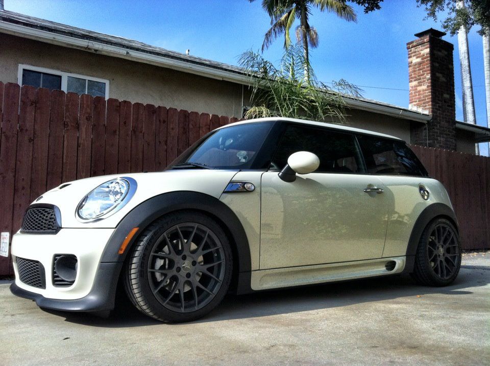

Hi, I just got fiesta st and I realized that my old mini cooper wheels may fit the fiesta.
These are the specs,
17x7 Breyton Race GTS-R Mini MG with 215/40ZR -17 Continental ExtremeContact DW XL
http://www.tirerack.com/wheels/Whee...&filterBrand=Breyton&filterNew=All&sort=Brand
My old (sold) mini cooper,
Thanks!
1 - 5 of 5 Posts
Tires should fit but what are the spec on the rims ?? Fiesta ST has a 4-108 with about a 47 offset
the MINI Cooper wheels bolt pattern is 4x100mm so they will not fit a Fiesta.
is: Offset: 40mm Backspacing: 5.51" Bolt Pattern: 4-100
AWWW!
